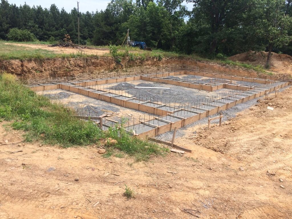

Finally... Got the footings poured for our house yesterday. It's been slow going, but at least it's going, and doing the excavation/forming/etc work ourselves the way we have has saved us thousands already even at this early stage. Basically, saving money by spending time and effort instead. So far, the only labor we've paid for is for the contractor (really more consultant & overseer) over the course of the excavation, and some guys one day for the footing pour. Other than that, it's been all us except paying for materials like the concrete, gravel, drainage pipe, etc. So it's slow going, but it means we'll be able to have it paid off sooner than we would otherwise.
At the bottom-left of the pic, there's another line of footing that you can't see much of, because of the way the ground slopes. Because the house design is segmented the way it is, we have over 300 linear feet of concrete wall, meaning over 300 feet of 15x36" footings. Just the footings alone took 41 yards of concrete.
The forming for the footings was a major project on its own. We used ~2350 ft of horizontal rebar, and over 300 three-foot vertical rebar ties bent at 90 degrees below the surface, to integrate poured walls into the footings. (Those bars sticking up out of the footings in the above pic.) All the rebar is the stronger Grade-60 stuff instead of the more commonly seen Grade 40. This isn't going to be a huge house, but it'll be a heavy house, and we intentionally erred on the side of caution in every aspect of the foundation.
It's good to see something finally going INTO the hole, rather than just dirt & rock coming out of it.

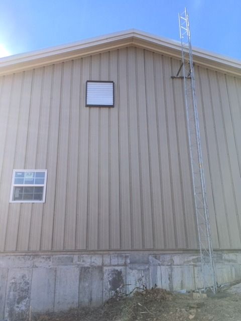

The concrete base, first 30 feet of tower, and the upper brace fabricated and bolted thru to the framing purlins inside:
Thirty more feet to go on top of that. Oy... :unhappy:

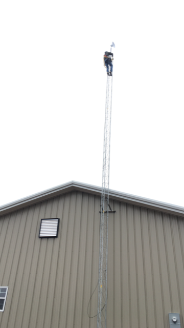

Sixty foot tower done and internet service online as of last week. The things you have to do in order to be connected to the outside world, when you build in the middle of nowhere...
See less See more
Wow!
:) We had to pay for the tower, so besides having the internet transceiver on top, we can use it for whatever we want. I'm thinking it will be a good mounting location for a cell booster and an over-air TV antenna. Probably not at the top; more likely just as high as I can reach on the tower while standing on the roof. (I've only been on the tower twice, and only went as high as that standoff bracket; no plans to ever climb to the top.)
I don't like cell boosters generally, but in our case it's going to be nearly mandatory in order to get usable service inside, since the upstairs has metal roof & walls and downstairs has a tighter-than-normal grid of rebar in the concrete walls. All of those things work together, to the detriment of cellular signal.
On the TV antenna thing, right now other than AM/FM radio the internet is our only communication path to the outside world, meaning no local TV channels. We don't have cable (obviously) or satellite TV service, so I'm thinking a long-range antenna pointed toward Little Rock would get us some local channels. In addition to the internet service, that should set us up pretty well.
I'm also thinking the tower might be a good mounting spot for a high-def PTZ camera one of these days. Our house location is on one of the highest spots around, and as far as I can tell, the tower probably is the highest. We have good (fixed) HD cameras in place now, but a PTZ way up there could be kind of cool.

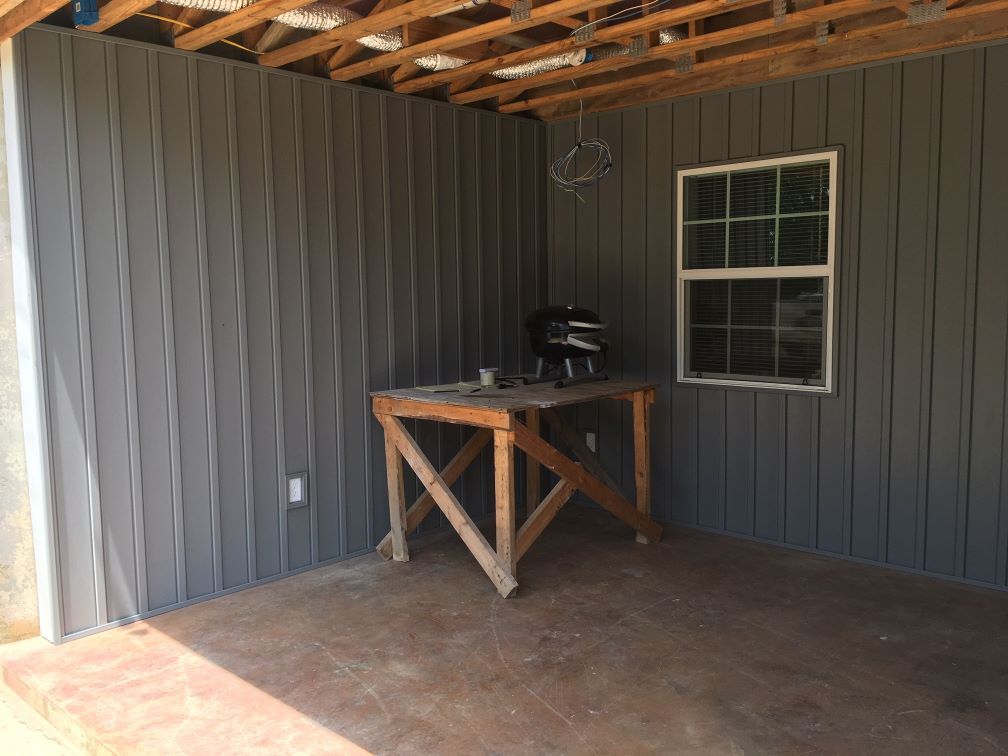

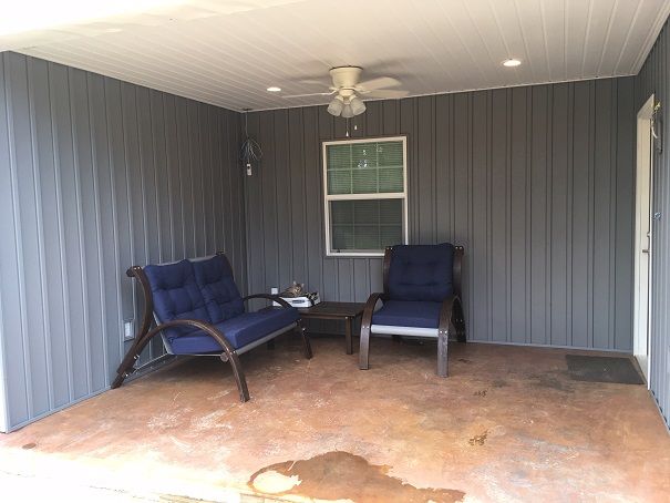

Took me two weeks of nights & weekends, but finally finished the small downstairs porch. My wife loves being outside but can't be in the sun much now due to her medicines, and she's loving this. This faces the back yard toward the pasture & pond and there's often deer literally close enough to toss apples to.
Dark spot on the floor is just water; I had to spray away some dauber nests. The wiring on the right is temporary - they're currently feeding outside back floodlights, which will eventually be controlled from a different switch than now. A typical 'carriage' porch light will be there eventually.
One more project down, fifty or sixty to go...

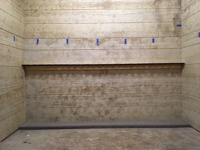

Not finished, but darn close. Can’t really tell in the pic, but the base is raised in the front & angled down in the back, to lean the long guns against the barrel cutouts better. The blue tapes were just to mark stud and conduit locations.
Bought the door today that goes on it; should get that installed tonight if all goes well.

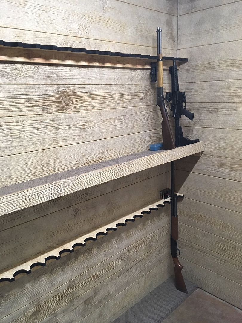

Low-res pics, but finished the long gun racks in the new gun room. Tall stuff on the bottom row, short stuff on the top, medium stuff (like that 16" 1892) can fit on either. Don't have enough long guns to fill all of the slots, so the plan is to steal some of the upper-row space for handgun-hanging shelves.
Door is in & reinforced with 4-inch #14 screws and metal plates, which may be really unnecessary as this little closet-size room is inside the safe room itself. Honestly think having the guns all visible may lead me to selling off some of them. They've been kept mostly in safes for years, out of sight and split up into smaller groupings, and I'm thinking that having them all consolidated and visible will eventually lead me to pare down some. Used to be, a new gun was fun, but anymore it feels like baggage more than anything else. Not going to pare down to the bare 'essentials' or anything; still plan on keeping toys for toys' sake, just probably will get rid of some toys.
